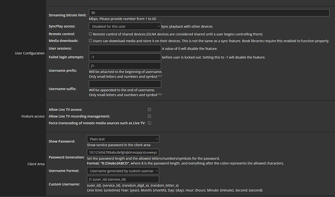

Description of the Issue / Question
Username format not being followed
Steps to Reproduce (if it’s a problem)
  1. Set username prefix to j1-
  2. Set username format to Username generated by custom format
  3. Set custom username to {user_id}{service_id}
What You Expected to Happen
I expect a user to be provisioned with format like j1-271-1795

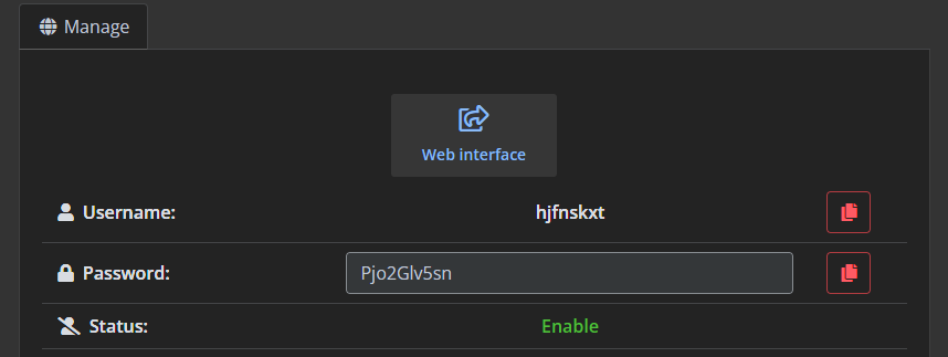

What Actually Happened
Random username is generated, like hjfnskxt

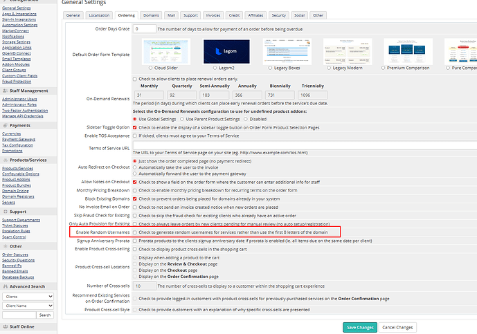

The behaviour you are observing is not a bug in the Jellyfin WHMCS module but expected system behaviour. Username generation in this case is being controlled by WHMCS global ordering settings, which override the module’s custom username rules.

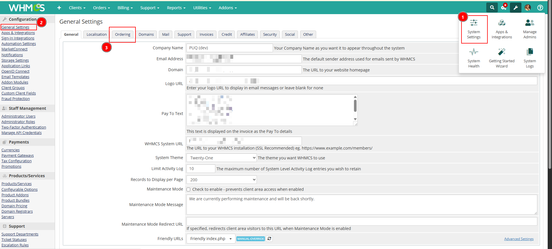

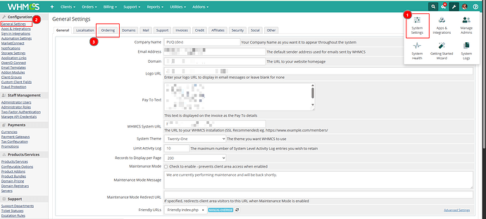

To allow the module’s custom username format (prefix + custom pattern) to be applied, please disable the Enable Random Usernames option in WHMCS. You can find it here:
Configuration → System Settings → General Settings → Ordering tab → Enable Random Usernames
This option in WHMCS is described as:
“Check to generate random usernames for services rather than use the first 8 letters of the domain.”
When this option is enabled, WHMCS forces random usernames to be generated and ignores any username format configured in our module. Once it is disabled, the module will correctly apply your custom username format (for example: j1-271-1795).
